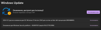

Greetings! obs does not work for me at all after updating Windows.
…tried to reinstall - nothing. deleted all plugins - nothing. deleted obs and all files - nothing works again.
I start a clean obs, try to add my capture card and it crashes…wtf?)

I fix it backup windows update.
Win 11 update kill OBS
