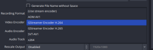

I was trying to set up to record gameplay but I can't seem to find the proper encoder settings. I tried setting up gstreamer to try and fix it but it still doesnt show my GPU as a device.
GPU is a 7800XT. I am on EndeavourOS.

Code:
20:49:11.369: VAAPI: Failed to initialize display in vaapi_device_h264_supported
20:49:11.369: FFmpeg VAAPI H264 encoding not supported
20:49:11.369: VAAPI: Failed to initialize display in vaapi_device_av1_supported
20:49:11.369: FFmpeg VAAPI AV1 encoding not supported
20:49:11.369: VAAPI: Failed to initialize display in vaapi_device_hevc_supported
20:49:11.369: FFmpeg VAAPI HEVC encoding not supported
You may be missing some drivers.

Thanks for the fast response. You are correct, I installed libva-mesa-driver and it fixed the issue.
